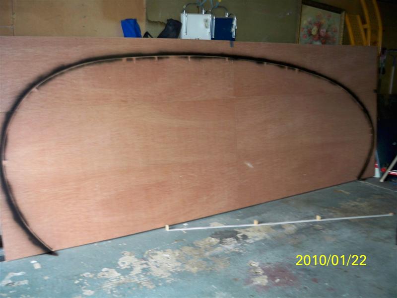

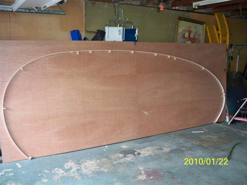

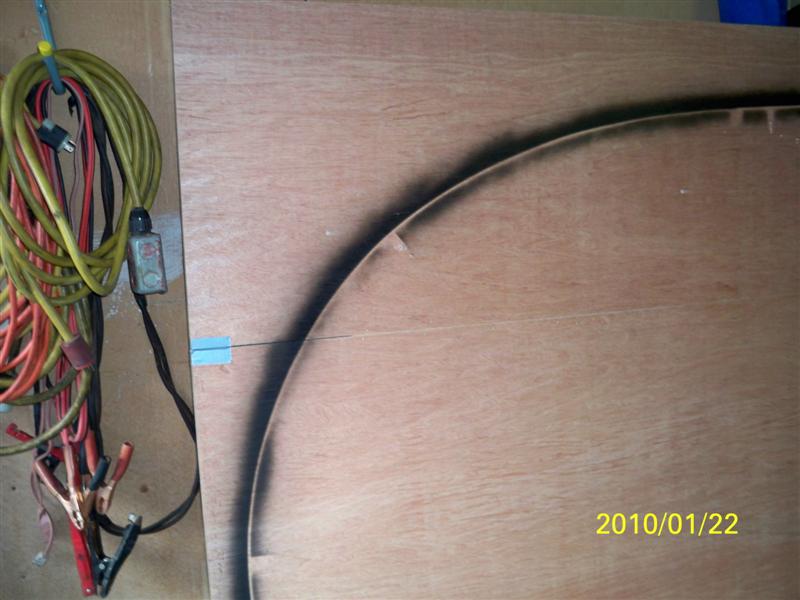

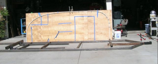

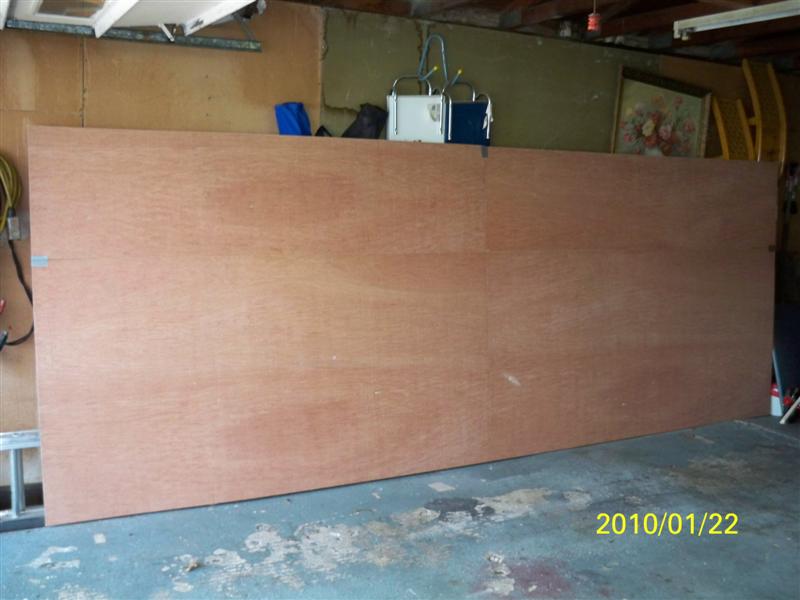

Made some more progress today, got my wood for my pattern put together and after making some dimension marks I used some plastic lattus strips to lay out my pattern. after making some adjustment I used black spray paint to mark my lines. Now all I have left to do is break out the jigsaw and cut it out...
Greg :)

What is "lattice strip" and where did you get it. I used sched 125 pvc pipe but I like your technique for marking the curve with spray paint.

Postby vairman » Sat Jan 23, 2010 12:15 pm
eamarquardt wrote:And I thought my frame was strong.
I think you beat me!
I like the shape of your tear. I think I'll try and get closer to your shape. I'm gonna keep the vertical front to maximize interior floor space but I like tucking in the rear end a bit. Here's my current mock up:
Where the two horizontal blue tape stripes end will be the cabin's rear bulkhead with about a 14 inch storage space with a door on each side. I'll have a 20 gallon water tank , the battery, and room for chairs and other stuff so I don't have to store/carry stuff in the cabin when traveling. The galley will have a small r/v range/oven and a 3 way reefer (on hand) installed.
Looking good.
Cheers,
Gus
Hi Gus, the plastic Lattice strip I got from Home depot in the molding section it's about $3 for an 8' strip and it is very flexable. I just stapled it to some wooden blocks and then screw it down to the pattern and made adjustment till I got what I wanted...
Greg 8)

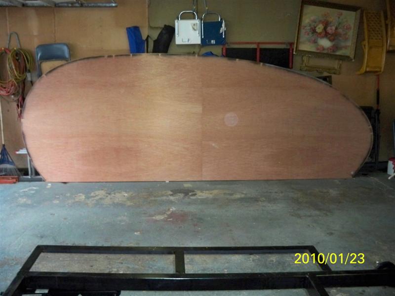

Postby vairman » Sat Jan 23, 2010 5:09 pm

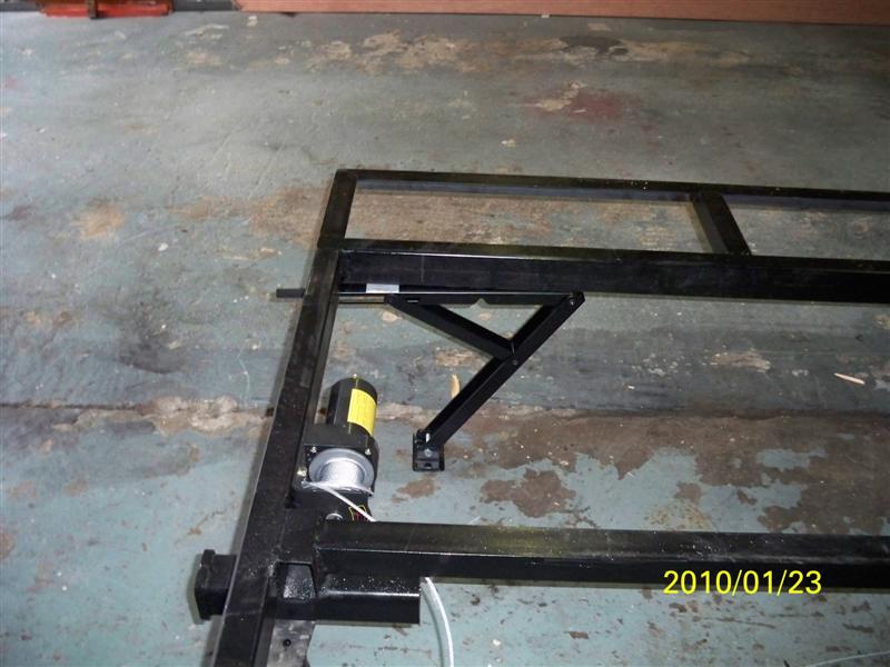

Got a little more done today, I cut out my template and installed jacks to the frame...
Greg

Postby aggie79 » Mon Jan 25, 2010 9:39 am
Greg,
I really like this design! I too used a plastic lattice strip (one with the light color fake wood grain) to lay out the curves, but I had trouble tracing the curves because the strip flexed too much. I ended up having to stick on some inner blocks with double-sided tape to hold the strip in place. Your method of using the spray paint is a great idea. Thank you for posting the pics.

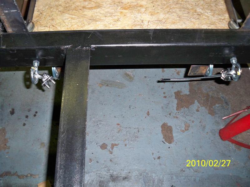

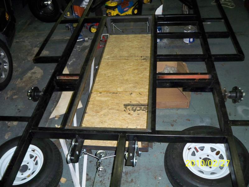

Postby vairman » Sat Feb 27, 2010 10:32 pm

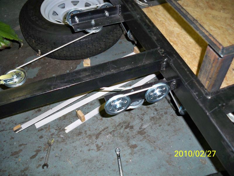

Well after a slight pause in the building of the Super tear i have gotten some more done, I now have the drop floor operational...
Floor Dropped
Floor Raised
Some closeups of the pulleys
Greg :D

Postby starleen2 » Sat Feb 27, 2010 11:26 pm
I know you probably thought of this - but I have to ask - where is the safety margin in case a cable fails when towing? It sure would be a great sparkler if that should happen at highway speed - you may want to add some safety pins when in the Up position :thinking:

Postby vairman » Sun Feb 28, 2010 8:17 pm
starleen2 wrote:I know you probably thought of this - but I have to ask - where is the safety margin in case a cable fails when towing? It sure would be a great sparkler if that should happen at highway speed - you may want to add some safety pins when in the Up position :thinking:
Well lets see 3000lb cable cap. I think that there is a bit of safety margin, but then again the floor lowered still has about 5" of ground clearence...

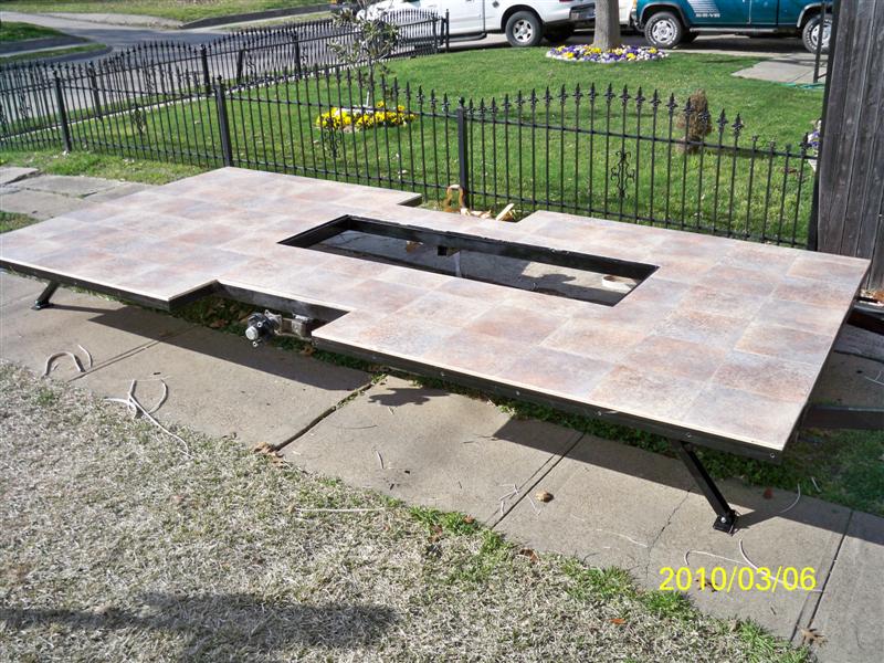

Postby vairman » Sat Mar 06, 2010 9:07 pm
Ok I got some more done on the tear today, got the floor installed... And Danny, I did get a weed eater after those weeds :)
