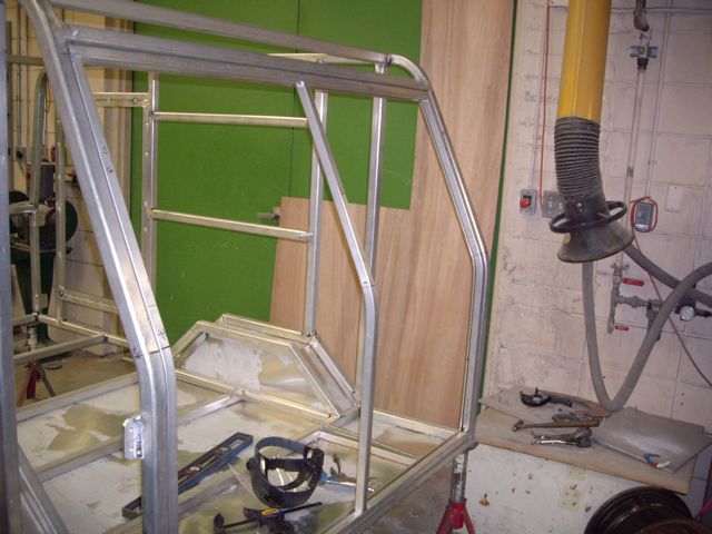

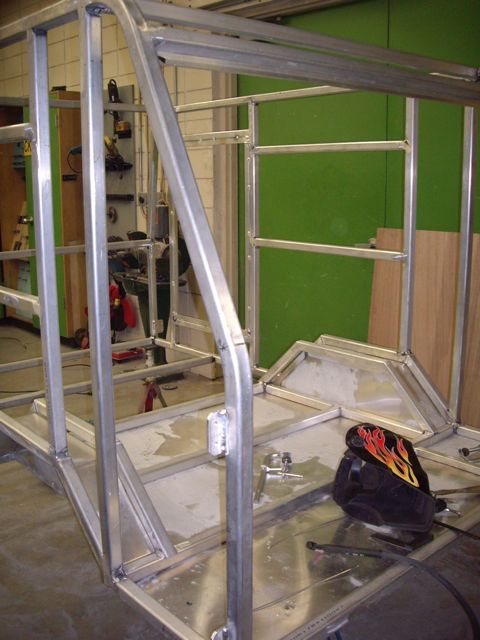

Well after researching and saving for a while I have finally begun my build.
My concept is a modular trailer, in that, since I don't already have a utility trailer I want the camper to be a removable unit.
For this reason I have framed the camper with aluminum tube to make it bombproof!
The progress is going fairly slowly from my perspective because I need to anticipate all possible welding before I begin any covering
so the entire thing has seemed skeletal for much longer than I would have liked.
Anyways here are some pictures of my progress.
You can see the doors on each side framed and the windows as well.
The skins on the bottom were a real pain to weld on because the oil canned and warped pretty badly but I wanted to be sure that no water or elements could ever get in.
You can see the jack points that I have welded for each corner so that I can lift it off of the trailer and the rear hatch profile.

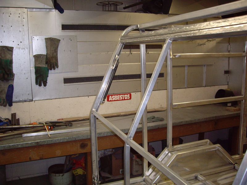

Postby asorensen » Sat Apr 23, 2011 4:01 pm

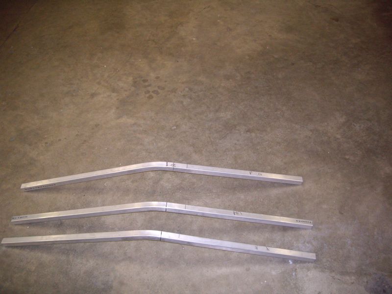

I am pretty happy with how my rear hatch has come out.
These are the ribs that match the profile:
Here they are welded into a frame and fit into the space:
I used an aluminum piano hinge that I welded to both the camper and hatch. I learned a few things welding this one in that will help with the others that you will see later.
Mostly that the welding burns off all lubrication so the hinge needs to be lubricated before any moving or risk galling (sticking) the parts.
I was able to figure out good locations for the struts by clamping in place before hand.
I am sure that if I hadn't been able to clamp and try various locations first it would have been a very frustrating afair.
Here they are finalized. You can also see the rear latch:
And closed:

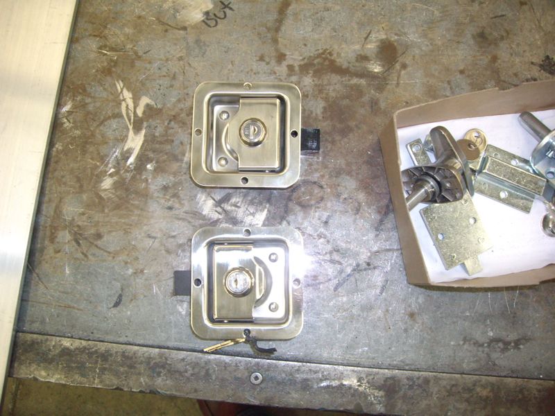

Speaking of latches I was pretty happy to find these ones for the main doors:

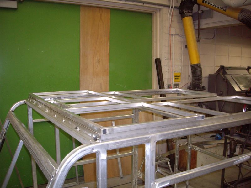

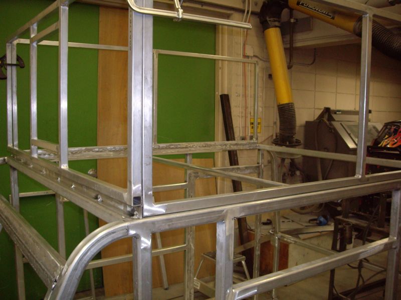

Postby asorensen » Sat Apr 23, 2011 4:16 pm

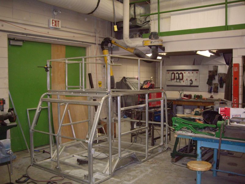

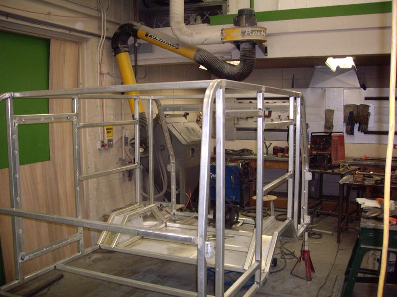

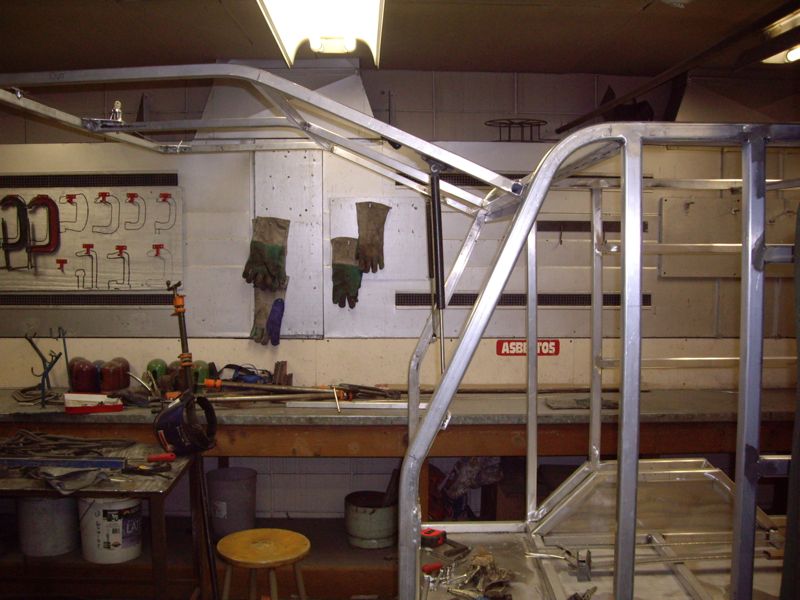

Because I have three kids I knew that a standard tear drop would not quite be sufficient.
The area that I live is not conducive to tents (read wet) so as much as I liked the idea of a roof top tent I didn't think it was the best solution.
I decided to go with tilt up walls to give a standing room and a loft while still keeping the profile height fairly low (more on that to come).
The walls are framed with 1" tube and add an extra 24" of interior space allowing me to stand easily.
Here they are somewhat complete:

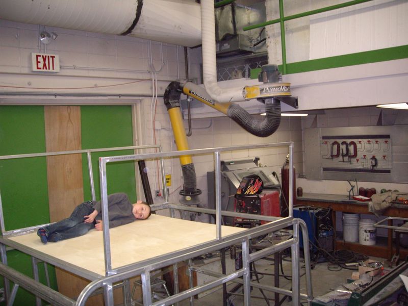

And folded down:
This is the size that the loft space will be:
This should fit the kids for at least a few years!

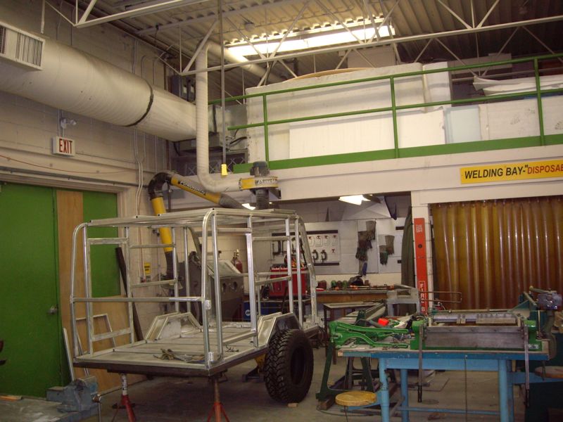

Postby asorensen » Sat Apr 23, 2011 4:34 pm
So that brings you all pretty much up to date.
I have begun the trailer that the camper will sit on and come to a bit of a standstill for a couple of reasons.
The first is that I cut my hand and had to get four stitches nothing major but a good reminder that I actually want to keep everything that God gave me!
The second is that I am waiting for parts. I have ordered a whole pile of things from R and P Carriages and I had to have them shipped to a friends in the States and now have wait for them.
Lastly I am somewhat second guessing my choice of tire size for the build. I plan to build trailing arm independent suspension with air bags and shocks.
The proposed trailer height based on the tire size of 31"x10.5"x15" tires was 24" inches but after putting the tires under the trailer I am wondering if it is too high.
Basically I don't want it to top heavy and I think at 24" trailer height it might be.
Here is a picture at 24" with the 31" tires:
I have left 4.5" of clearance in the wheel well for travel.
I plan to have a spare under the deck of the trailer and water tanks.
What are peoples thoughts? Is it too top heavy?

Postby asorensen » Sat Apr 23, 2011 4:38 pm
Thanks for the quick replies guys.
Nice frame ya' got there - Whatcha plannin' on skiniing it with??
I will be skinning the outside with frp and inside with 1/8" ply with rigid foam between.
Andy
