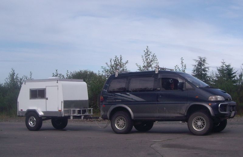

We travelled from Vancouver Island Canada down the I5 to Sacremento and then slowly back up the 101 on the maiden voyage.
I am happy to say it all worked excellently with no mishaps or flaws along the way.

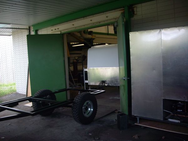

The trailer was the next major hurdle.
I had decided on independent suspension with airbags and shocks so I needed to make up swing arms.
Here is first swing arm and the jig:
This is where the swing arm will sit.
With the airbag:
I planned to put shocks on as well but as I was running out of time I opted to try it without for the first journey.
The result was that I had to run the airbags with quite a bit lower pressure than I had initially planned. This was to deal with the rebound issues after which it towed quite nicely.
Needless to say the obvious solution is to fit shocks as well which I will be doing soon.
Anyways here is the trailer all painted up.
I will continue the further build pictures tomorrow night.

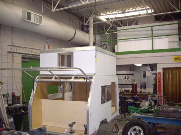

Carrying on with the build photos:

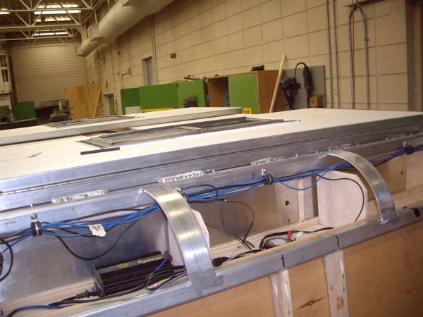

All of my wiring comes together behind the front upper bulkhead which became a electronics bay and storage location.
From inside:
From outside:

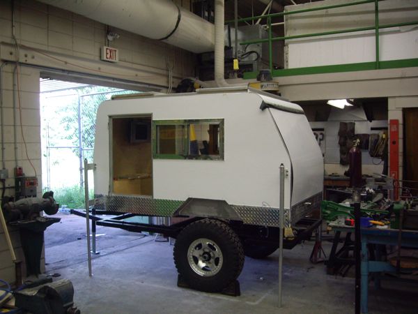

The outside skins went on very nicely:
Side and rear top up:
Side and rear top down:

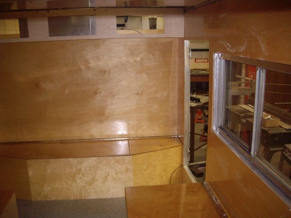

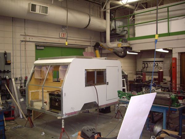

I started working on the galley configuration also visible in the last picture. I am very happy with my camp chef oven stove which I have fastened in place with plenty of airspace around it.
The front skin going on:
This was one of those tasks that it would have been nice to have a second set of hands to help with but alas since it was 3 am I was alone!

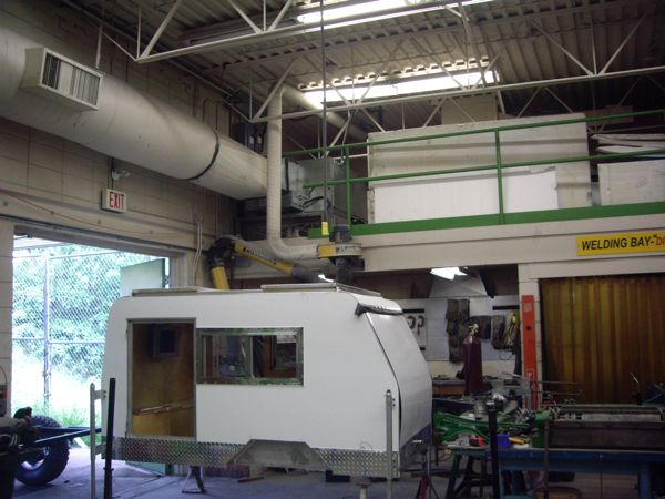

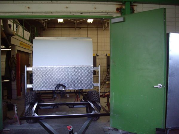

After the skins went on it was time to put it on the trailer:
The corner jacks worked very well:

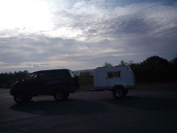

And I had to do a little run around with it up there. Here it is:
It looks much "cuter" then I envisioned while working on it. It had seemed quite large while working on it in the shop but behind the van the size seemed become much smaller.
Sorry about some of the picture quality. I munched the view finder on the camera so instead of having a "point and shoot" it is now a "point and guess".

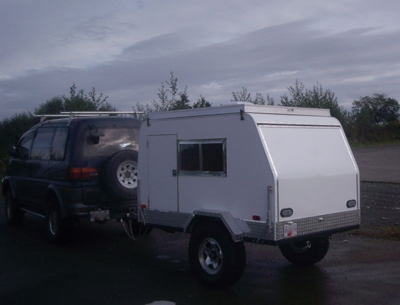

Here are a couple of updated pictures to hopefully get your creative juices flowing.
Thanks
Andy
