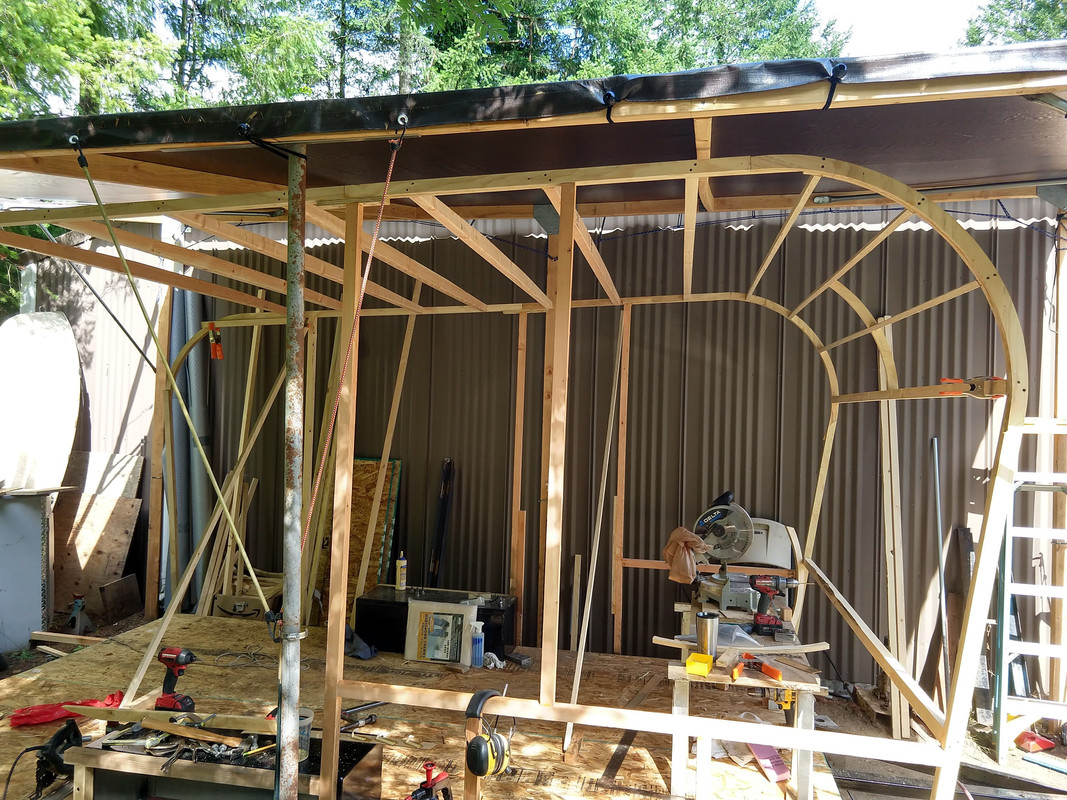

I had originally started my build planning on a foamie. As time and material and money have begun to work together, plans have changed. It will now be wood framed, sprayed with 2# expanding urethane foam, sheeted with plywood, and skinned with PMF.
Here’s the beginnings of build thread over in Foamies for those interested. It follows me up through the frame and subfloor.
viewtopic.php?f=55&t=71481
Over the last couple weeks, it’s been a little slow going. Planning, sourcing materials, etc. I had gotten my wall profiles partially completed flat on my deck. Stacked both together to ensure they are uniform. I had to build them in pieces. Here’s a test fit-up to see if the profile was acceptable.
Jump ahead to today- had a kick-butt day, and got a pile of progress made!
Still have a bit of framing to do for windows, hatches, and the door. I ran myself out of material though.
Another day, I suppose...

As I look at these photos do I see a crown to your roof spars? Or is it just the photo direction?

Yes you do. At 8’ across, I wanted to fight sagging over time. It will never be a walk on roof or need to carry a load, it’s just all about that old, frumpy sagginess over the long haul.
I already have 4” of drop front to back, so runoff is not a problem.

Have you thought about the compound bend you will need to make with the roof skin? At some point the roof ply will come off the curved spars and need to attach to a flat spar. Will the curved roof panels hit a flat spar before the panel needs to make one of the tight bends for your profile? Plywood bent in 2 different directions can get real nasty to deal with. Just curious as to what you have in mind.

Mr. Lahey wrote:Have you thought about the compound bend you will need to make with the roof skin? At some point the roof ply will come off the curved spars and need to attach to a flat spar. Will the curved roof panels hit a flat spar before the panel needs to make one of the tight bends for your profile? Plywood bent in 2 different directions can get real nasty to deal with. Just curious as to what you have in mind.
Yes. I have a transition section with one spar that isn't crowned. It will (should) allow it settle flat before the rollover. I'm banking on the radius of the profiles to put the wood in enough tension to retain that transition section and keep it from sagging. I will need to have a seam at that spar to make the transition with two separate sheets We use this system at my work with aluminum sheets.

Why not model it to prove the concept.. :thinking:

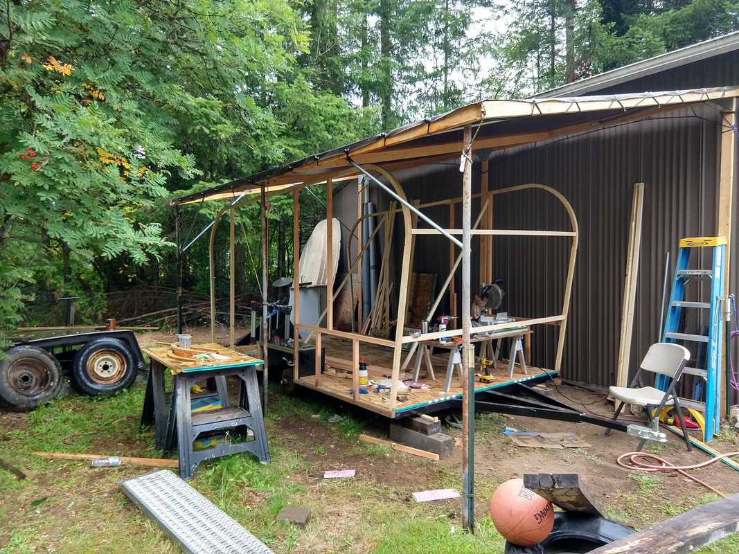

Had a great weekend getting a ton of work done. I wrapped up all the framing details, including some rework to account for a window change over the dinette on the rear wall. I got started late Saturday with some plywood, and got almost completed today. That roof and the curves were troublesome to say the least. Mostly just because I don’t have a 40x80 shop with 16’ ceilings, scaffolds, hoists, and A/C. My transition sections on the roof, did however work fantastic. I had no trouble at all going from the flat to the crowned sections. I left the easy pieces off, mostly to give me access for tools, cords, hoses, etc.
still need to router out my openings, do a little bodywork, and I can start the canvas. 8)

We spent of the long weekend playing with friends, camping, riding and teaching the kids to ride dirtbikes, good food, good friends... I opted out a little early today to try to get some work done. I really need this thing dried-in and painted before the weather turns!
I was able to finish up all of the bodywork and fairing, as well as getting the fenderwells cut out.
I got both sides canvassed, and an additional coat of 50/50 TB2 on one.
